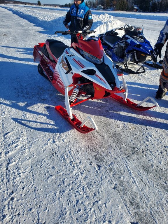

Installed some MOFLO vents to get the header heat out. Very happy it's amazing how much heat it allows to escape.

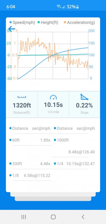

One of my test hits from last week. Starting to get her dialed in.

I told you you would make a rocket. Awesome good for you glad all your work is paid off.
My best is 10.97 at 100 mph letting off too early with the gap large turbo and stage 6 cams.One of my test hits from last week. Starting to get her dialed in.
What gearing are you running ?

Up to this point 1.64 ratio 25-41. Just switched to 1.68 22-37. I also want to try 1.54 24-37 and 1.58 24-38. Just a pain to change gears in this chassis.My best is 10.97 at 100 mph letting off too early with the gap large turbo and stage 6 cams.

The winder loves big gears. I run 1.54 and if running a mile or more on good hardware ..... the mighty SRX flies......but man ....... sure is hard to keep a belt intact!!

FWIW - I've run 1.68 and 1.81 with my Razorback IR belt temp gage. On my setup, I can tell you the higher ratio definitely heats up the belt more. Like about 15-20 degF. To me, that's something to keep in mind when running tall gears. Depends on how far one is going to pull it. Also, for the fast trail riding I do, by marking clutch, I can say the primary doesn't get shifted up all the way very much. Have to pull it quite a ways for the last of the mark to be wiped off.

That's allot of gear! and running a mile or more is hardcore!The winder loves big gears. I run 1.54 and if running a mile or more on good hardware ..... the mighty SRX flies......but man ....... sure is hard to keep a belt intact!!

Gearing is subjective.... just like drag racing... you gear for the given distance you are running... theoredically ... for best accelereation in a given distance.... YOU ONlY WANT TO HIT 1:1, ... as clutchs go into overdrive you loose efficientcy. if you are radar running for say 2000 ' which should be plenty to get to top speed.... gear soo you hit that 1:1 speed right at the 2000 foot mark.... but this will be such a tall gear it wont be good for trail riding aswell. cake and eat it too...
