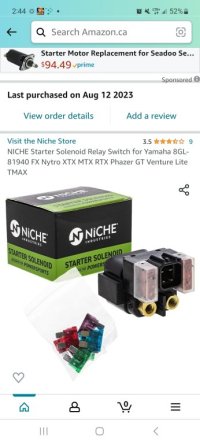

Brit1230
- Aug 12, 2023
- New Brunswick
- 2009 yamaha nytro xtx
Mine clicks bit there's nothing when I use a screwdriver to bypass?The starter relay gets moisture in it and after sitting the mechanical contacts corrode. When the key is turned you'll still here a click which is the contacts coming together but due to the corrosion the starter won't be energized. Because you hear a click everything up to the relay is working properly. The only other issues would be a poorly charged battery or a bad starter but by jumping the relay you narrowed the problem down to a bad starter relay.

Brit1230
- Aug 12, 2023
- New Brunswick
Tried that still nothingSounds like your battery. Try jumping it from another battery.

If you are positive the batteries are good, and you are correctly jumping the solenoid, its likely the starter as there isn't anything left. Don't know anything about the nytro starter though, hopefully someone gets back to you.
RAMSOMAIR
Starter is bad. magnets likely fell off. I've repaired a few like this.

Brit1230
- Aug 12, 2023
- New Brunswick
So if I cross the the solenoid and there's no sparks it's the starter?
If you can hear starter whirring when key is turned and one way is confirmed working I would bet starter is turning backwards. When you took it apart for brushes you didn’t get the 3 sections lined up correctly. Look for protrusions on aluminum ends and paint marks on center section.
Supa Dexta
Just had the magnets fail on mine. They all rotate inside the starter body and therefore the motor doesnt turn. Relay clicks, but doesnt attempt to turn starter. Putting 12v directly to starter stud will confirm this failure. Remove engine mount bolts (long one behind secondary clutch and 2 up front) pry motor away from heat exchanger - carefully - put something flat against heat exch. to pry against, and pull starter out to change. Can do it with sled leaned on its right side, and not even have to drain the oil.
