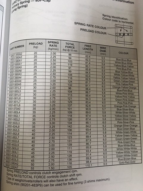

I can barely see that image....does that say 55/105 for our spring? Any chance you can take a better pic larger?

is that 55/105 or 110?

I think 110.1 is the length

55/105
Added to FAQ

correct it is 4.290 thou.I think 110.1 is the length
