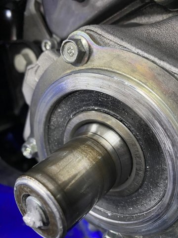

Are you sure you don't have the two pics mixed up? The second pic sure looks like bearing is seated. First one it does not. If you have a feeler guage take note of how far it goes in. Each corner of the bearing and the housing has either a radius or chamfer so a picture really can't be trusted to show whether it's seated. I think you made it the right call replacing it since the seal was pushed in surely. Probably crushed the cage and could have failed.Ok couple of things to note:
1. As I mentioned above, the only two stub shaft assemblies I've ever seen are the one I removed from my machine and the new one I unboxed from Yamaha. Both had a gap as shown in post #20 above. I intend to buy another assembly to toss on the shelf. When I get it, I'm very interested to see what kind of gap it has. If knowledgeable people like Cannondale say it should sit flush with no gap, then I'd trust that when disassembling/reassembling!
2. What I mentioned in post #28 regarding a concave slope inward from the outside portion of the bearing to the center of the bearing is shown with the following pictures. On my old stub shaft assembly, there is a 1.17 mm inward slope from the outside of the bearing seal to the inner portion of the bearing seal, and it is visually obvious in person. On my new stub shaft assembly, that surface is visually flat (I didn't measure it before I installed it, but it was visually flat).
3. For what it's worth, on my old stub shaft assembly, there is a 0.011" gap between the stub shaft collar and the bearing seating surface. I didn't measure the new one, but when I get my shelf unit, I'll measure that one to compare.
Cannondale, pics are definitely not mixed up. You can tell by the pics below (specifically, the wear marks/ring on the shaft) that the pic in post #20 of the old stub shaft is definitely the old stub shaft. The gap distance on the old stub shaft is 0.032". Didn't measure the new one because I didn't know this was a thing. I have my dad's '20 in my trailer. REAL tempted to pop his primary off and see what it looks/measures like. He hasn't blown a belt and only has ~150 miles!

Will the stub shaft bottom out on the crank inducing side load on the crank?
I have not had mine out, it only is in .004" compared to a new stub shaft assy.
In your pics you can see the bearing retention ring is definitely lower on the new one compared to the old one which means the bearing is seated either deeper on the stub shaft and/or deeper into the retention ring so your primary clutch will now sit further out away from the engine.
Interesting. I'm at ~60.5mm offset right now with the new stub shaft assembly (TAPP/stock secondary). It seems if my bearing was seated against the housing my offset would drop by that distance, which seems to be 1-1.5mm. That would take me down to 59-59.5mm offset, which is where I should be! This is BS I expect when I order a stub shaft assembly it would come from Yam drop-in bolt-on ready! Guess not. I just ordered another one though. Will update with pics/measurements when it comes in.

Why would you order up another one? Just push it apart, clean up, put green loctite on it an push it together. They need loctite as to not move anyway.
Factory assembly does not come with loctite and one belt blow and it slides in anyway.
Hey would you order up another one? Just push it apart, clean up, put green loctite on it an push it together. They need loctite as to not move anyway.
I agree...set the new one up properly with green Loctite and then you know its done right
