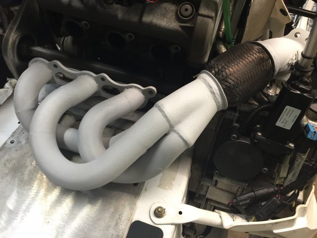

Oh the Louvers. Ceramic coat the exhaust manifold and pound the louvre flat. Yes that might be a issue.
I had that issue with the Evo header which hung in hole a little to far! Pretty good pattern eh?
So I did this. Notice this header is short like yours on Sidewinder. Just be careful. Gets real hot in there!

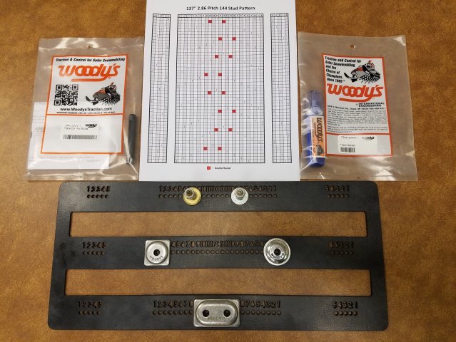

What's everyone using for a pattern is there anything that keeps it off the center
I just quickly came up with this pattern which avoids the center 2" of the track. You can use this in combination with our studding template. It has 144 studs down the center and 48 on the outside for a 137" long track. A similar design can be used/created for a 129" track.
Is there a 192 pattern for it I see a PDF below the picture but nothing comes up
nice pattern tool...guessing its going to be the middle 3" that needs to be avoided....
