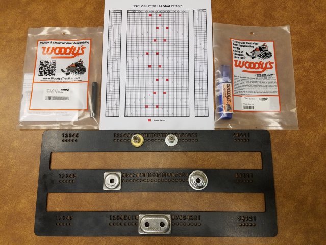

Sorry, but how is this pattern not avoiding middle 2-3" of track? I dont get it.I just quickly came up with this pattern which avoids the center 2" of the track. You can use this in combination with our studding template. It has 144 studs down the center and 48 on the outside for a 137" long track. A similar design can be used/created for a 129" track.
When utilizing the black template shown in the image above, you just follow the design shown below. This design shows a studding pattern with 112 studs on the inside and 48 on the outside. The one shown below will avoid studding within the center 3" of the track.
This pattern shows 168 studs on the inside belt and 48 on the outside for 216. The template itself is universal and countless stud patterns can be created from it. Each row represents a lug spacing on your track (48 in total on a 137") Hopefully this clears it up.
