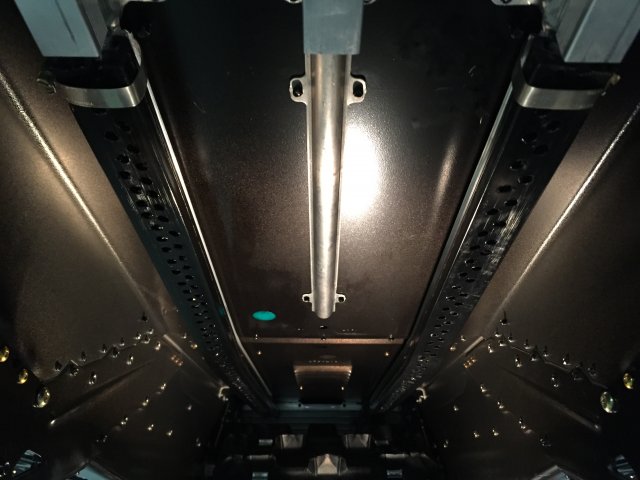

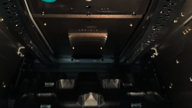

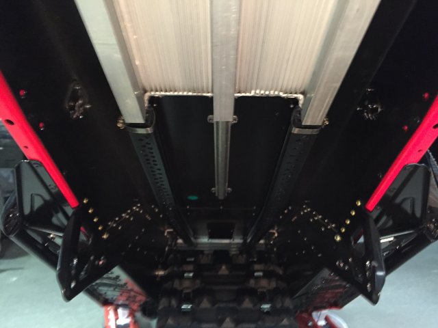

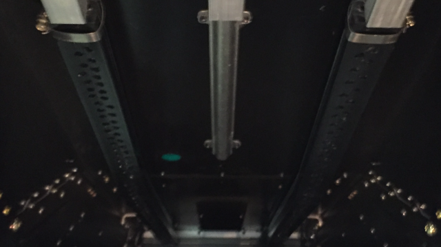

View attachment 123579 View attachment 123578 View attachment 123577 View attachment 123576 I wasn't going to take any chances on my winder. Decided to ad some extra protection using some DOO Sliders.
There is less clearance with the stock winder set up with the louvers than on my 11 Apex SE had. I was nicking the exhaust on it before I shimmed up the exhaust.
I'd rather be safe than sorry.
Here is some pics.
Not sure about all them holes in those sliders. If your track comes into contact with them it will grab hard and possibly start chewing up the track. Been there done that.
I have done this before on a few sleds with a lot less track to protector clearance with no issues tearing up a track. Even wore the sliders down a bit from rubbing and had Zero track damage.
Maybe if you were riding on grass/dirt with no lubrication you might have a problem.

Nice...but if you don't stud in the middle we are talking about it' shouldn't be an issue...
What I'd be concerned with is the scrubbing of the track...especially the leading edge and pulling on the coolant line
If talking about the coolant line on the right side at the front I took that into consideration. I relived the sides of the slider at the front by 5" and slider goes under the hose to protect also. No way hose would be pulled even if slider grabbed and pulled forward.
