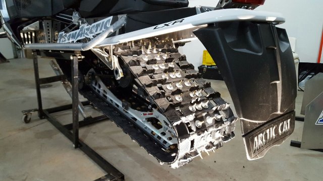

Interestingly, here is what a local Cat dealer (one of the larger ones in the state) did just this past week.
- 3,158
- 383
- 1,663
- Sauk Prairie, WI
- www.ty4stroke.com
Those studs look short. Should be fine.Interestingly, here is what a local Cat dealer (one of the larger ones in the state) did just this past week. View attachment 123777

I believe they are 1.325 Woody's Gold Diggers. I'm planning on that same size myself.Those studs look short. Should be fine.

What do you guys think of this pattern?
129" track 135 1.325 studs
129" track 135 1.325 studsView attachment 123889
wont win any races lol fine for basic braking traction...will spin on hard acceleration
