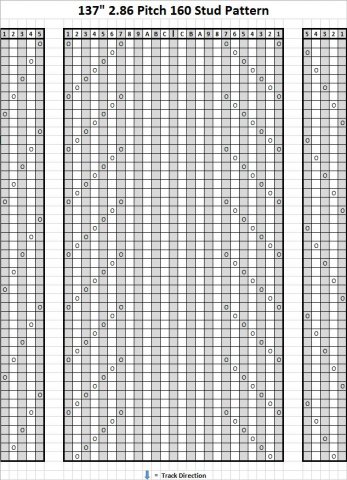

ok i hope i got this right i can use a 1,450 and be safe? what stud would you prefer and if you are selling this temp plate i would like to buy one also what backers should i use. ThanksWith a properly installed 1.325" woody's stud on a 1.25" lug track, you will get ~.375" over the lug. A properly installed 1.450" woody's stud on a 1.25" lug track will put you at ~.500" over the lug. I have used calipers for this measurement because I have OCD, haha. Below is a woody's chart explaining stud length.
if you install 1.450's and have .500" protrusion....you would have approx .125" or 1/8th inch to spare...IMHO you will hit possibly when the track balloons or grabbing a hand full of brake......

i will go with 1.325 then Thanksif you install 1.450's and have .500" protrusion....you would have approx .125" or 1/8th inch to spare...IMHO you will hit possibly when the track balloons or grabbing a hand full of brake......

if you do sell these i would be putting in 160When utilizing the black template shown in the image above, you just follow the design shown below. This design shows a studding pattern with 112 studs on the inside and 48 on the outside. The one shown below will avoid studding within the center 3" of the track.
Id go the 32 more and have a stud every outside row for support

i can do that also. lol so what studs do you recommends and backers. do you know if the temp plate is for sale.Id go the 32 more and have a stud every outside row for support

2000srx (cb performance) sells the template...good to have for other sleds also if you like making your own pattern (I do)..

I just talked to the dealer again and he mentioned not only staying out of the exact middle, but also away from the sides a little as well? I don't mean the outside either (was only going up the middle to begin with. ) Does someone have a pattern like this?
