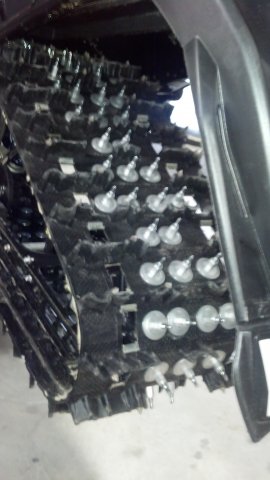

I ordered mine not to long ago. Talked to someone at woodys they had me order the 1.575 mega bites. Installed them a few days ago and they are correct size for the track which I found odd as the track is supposed to be a 1.6
Yes the Woodys Grand Master 1575 stud is correct it is 1.98" long overall!
I have 148 of them installed.
Here is the application guide remember it is a single ply track and requires this stud and the round Grand Digger plates
http://appguide.woodystraction.com/my-sled/2014/Yamaha/SR-Viper-X-TX-SE

Picture looks good! So your stud lenght it 1.98?? I was told 1.625......Yes the Woodys Grand Master 1575 stud is correct it is 1.98" long overall!
