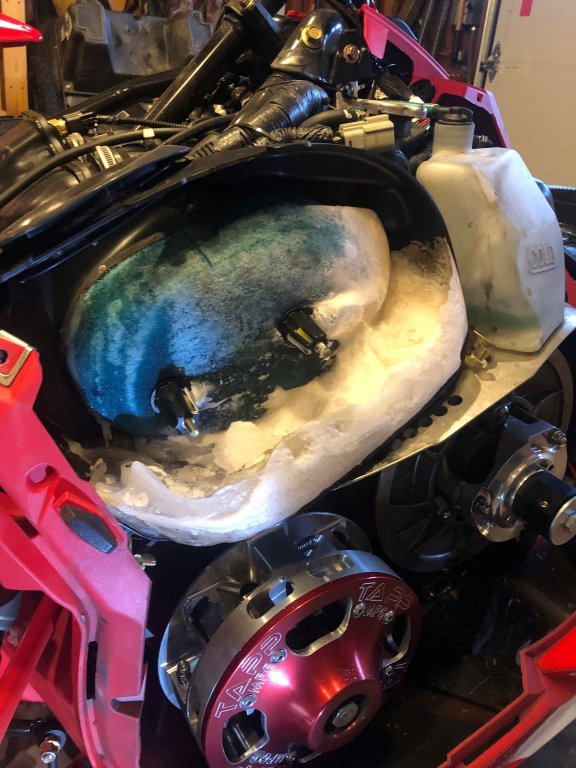

Would that get clogged with snow? This is a mtx so sometimes I have snow coming over hoodThe GAP underhood cold air delivers all outside air.
I have had the Gap Cold air since they were first released and I have had zero issues.Would that get clogged with snow? This is a mtx so sometimes I have snow coming over hood
But...this was posted by another member in a previous thread on the Gap cold air kit, so I guess it depends on the conditions you operate the sled in.

That screen is fine, you'd have to wonder how that snow gets in there unless the screen is broken.I have had the Gap Cold air since they were first released and I have had zero issues.
