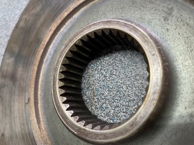

2021 srx with 6400km. Just pulled it apart it was worn so bad that I had to use a puller to get the rotor off the driveshaft.I get a lot of people that ask me what the easiest method is to determine if the drive shaft has been spinning so I wanted to share my findings. I find that removing the brake rotor and inspecting the backside of the hub is the quickest way to determine if you have an issue. If the shaft has spun, the face of the hub that seats against the bearing inner race will have lips worn on it. If you drag your fingernail across the face and it catches 2 lips/burrs then the shaft has spun. The bigger the lip, the more wear the shaft likely has. Below are some pictures. First picture is a perfect face. Second has slight lip, and the 3rd was removed from a sled with .015 of wear on the shaft.
View attachment 162633View attachment 162632

After 2 season of 1500 -2000 miles per, the shaft, bearing and rotor will show it’s wear.
Let it go further and you may have to cut the shaft off because the rotor won’t slide off the shaft, and it may take out other bearings on the end of the shaft’s other end, inside the chaincase.
Problem is, this is not something that gets checked through dealership yearly season maintenance, because it takes a bit of time to accomplish this check, and at over $100 per hour, well you get the picture. So many just wait for complete failure!

That is very true, yearly check is highly recommended.After 2 season of 1500 -2000 miles per, the shaft, bearing and rotor will show it’s wear.
I just checked my bearing and shaft this weekend, 7000km on my 2020 and shaft is still new, shaft has never spun in bearing, bearing and rotor all look good, But I did install BOP wedge since sled had 0 km on the gauge. Thanks BOP..
Can I reuse the brake rotor if my looks like that

The easiest way to tell if your driveshaft has spun. If it's all stock ""IT'S SPUN, OR GOING TO SPIN""!!! No if and's or but's. One of the shityest design's I've ever seen! Bite the bullet and install Travis's drive shaft wedge, problem solved! If your driveshaft is't worm too bad that is! Mine was worn .015 thousands in 5'200 miles so I ordered a complete new driveshaft with drivers and bearing from Partzilla 2 yrs ago. Put it together with Travis's wedge set at 40 lbs. ""PROBLEM SOLVED""!!!

I wish somebody would just reply to your question.....Can I reuse the brake rotor if my looks like that
ryama
- Mar 3, 2009
- 209
- 119
- 913
- Kitchener Ontario
- Sidewinder R-TX
- Kitchener
YES you can. Travis posted on another site it would be no problem.I wish somebody would just reply to your question.....
I'm using mine as my shaft is being welded and turned as I type and my rotor has the groove and is going on the shaft again.
