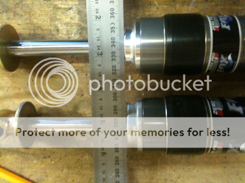

Here's a couple of pic's of the shock differences. There is maybe a 1/16" difference in body length, so no factor there. The new shock will have quite a bit less compression/rebound is much closer to the ZBros XO shock. The stocker is just too stiff IMO.

Here is a pic of both shocks:
Here's the body length difference pic:
