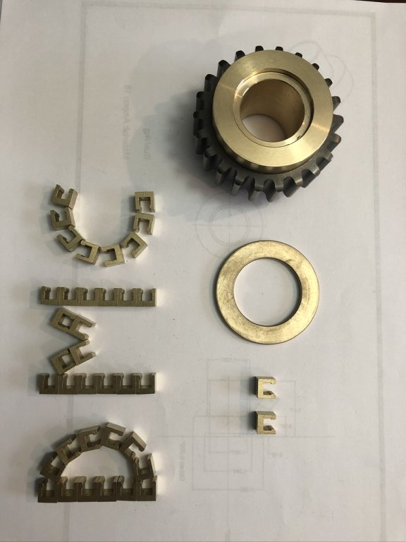

Looking forward to opening the chaincase this off season. My riding buddy (18 Tcat) and I (18 Winder) both have the DMC gear and have 2500 miles on them this year. Hoping to report some good info on the results of a season running this gear.
Pstn head
TnxsDMC will last life of the sled!

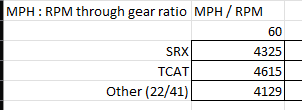

It will also be a slight bit slower to reach speed and it will be a bit faster top end. Its only 4% difference in gearing so it isn't a huge difference
Top is SRX stock, middle is TCAT 24/50, bottom is 22/41 gearing

But add a tune and a little bit of clutch adjustment.. Is it still slower to reach speed? And it should still have power to pull max RPM at the higher top speed. I have read here the tune will improve fuel economy too. Will I get the fuel economy to match my Sons 2009 Vector? I consistently use a gallon more per fill up. Not all that important, but if any of what I stated turns out to work, I will be happy. From what I recall it turns closer to 6000 rpm at 60 mph I like seeing it only drops 200 rpm, but i wonder if it could be more without becoming a dog.It will also be a slight bit slower to reach speed and it will be a bit faster top end. Its only 4% difference in gearing so it isn't a huge difference
