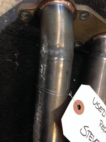

Heres pics. Obviously this was in fact my old header fixed up as evidenced from the burned shield remnants. I didnt notice that till out of package so this one definitly had hands on. I like that.
