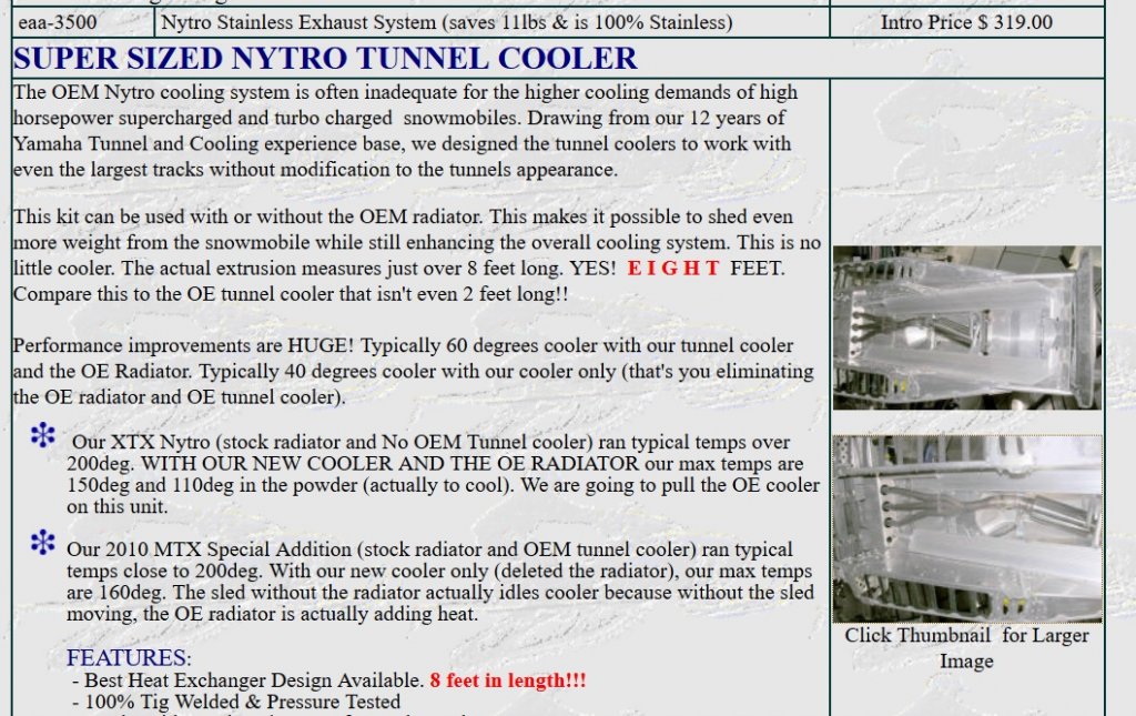

Grimm said:No need to R&D it...it's been done by Mountain Performance already. http://www.mountainperformance.com/yama ... oducts.htm

MPI (mountian performance inc) have them for the MTX....not sure if they fit the XTX, but should be adaptable. Search rad delete on TY and you'll find qute a few.

I'm running a mountaintech tunnel cooler (larger than the MTX by a bit) and have deleted my rad, sled runs nice and cool. Only time I've had overheating issues was running a very hard pack road for a long distance, if I would have had scratchers, I probably would have been fine.

I'm not sure if Mountaintech is still selling heat exchangers. I don't see them listed on his website. I wouldn't run it anyways without the radiator installed because it's still on the small side but the MPI looks like it has enough capacity to dissipate enough heat in most all conditions without the radiator.
