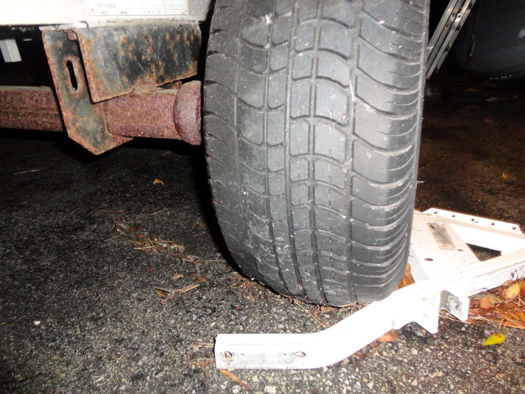

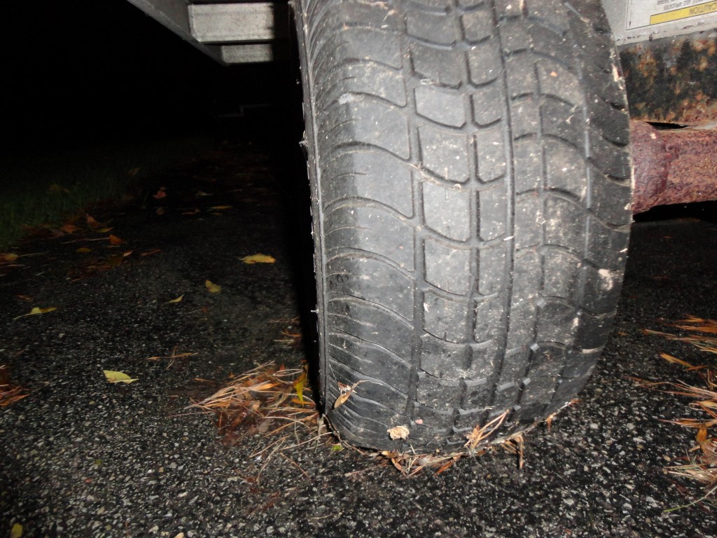

Guys what the heck is going on here? Is alot of mi on these tires but they are only wore on the extreme inside. Both tires. I keep an eye on pressure and never hauled more than two sled in the trailer. It seems to me like a alignment issue but its torsion Triton 12 ft. What can I do? Whats best tires of this size available? Or just normal? Loadstar 205/65-10 tires

Must be the tosion axle alignment. Never seen a leaf axle do that. Maybe toed out a bit.

I would take a few measurements to make sure your axle is square to the frame. If it is then I would say its bent slightly somewhere. My snowmobile trailer does the same thing but I know my axle is tweaked a bit so I just swap the tires around every couple trips and that evens the wear out.

Looks like your camber is off on the one tire and its tilted in . If it was a toe problem it would feather or chop the tire across the whole face. Not sure how you could fix it being torsion . I would say two new tires and rotate them . I believe there still is a stub shaft coming out of the Axel and then it attaches to the torsion spring maybe check the shaft for squareness .

Right and they are rotated every year. Wont do any good since wear is on inside of both. Was wondering if anyone ever shimmed the Stubshaft?
To be clear the issue is both. Same each side.

I had this same exact issue on my 10ft Triton enclosed. I could not figure out what was the issue other than tire pressure on a trip to Wyoming. So I put on new tires and started over. I am sure now to keep them within 5lbs of max pressure. 45-49lbs at all times. Dropping below will cause it from what I have seen.

looks like the rubbers are going in the tor flex to me. seen it quite a few times at work on higher milage/older trailers. my gf's 5'x10' enclosed with a spring axle does this to the 15" tires on it quite a bit as it is on its 3rd set in 10 years of her owning it.

I do. So you think it should sit higher? Dont see how that affects alignment.looks like the rubbers are going in the tor flex to me. seen it quite a few times at work on higher milage/older trailers. my gf's 5'x10' enclosed with a spring axle does this to the 15" tires on it quite a bit as it is on its 3rd set in 10 years of her owning it.

Are you thinking the upper cords are squished so the whole arm is at a angle? Crap if so thats only thing that makes sense. 2013 model. Has had sleds in it year round its whole life. Wonder if they would go back if I put jackstands under axle till winter?looks like the rubbers are going in the tor flex to me. seen it quite a few times at work on higher milage/older trailers. my gf's 5'x10' enclosed with a spring axle does this to the 15" tires on it quite a bit as it is on its 3rd set in 10 years of her owning it.

Wheel bearings could be getting bad. Jack up trailer and shake tire to see if there is a lot of play.
I think your right Maim. Can see a slightly larger gap on bottom of sq tube than top. Thanks
They are good. I am going to try taking weight off and putting new tires on. If I see them start to wear will need a new axle I imagine.Wheel bearings could be getting bad. Jack up trailer and shake tire to see if there is a lot of play.
