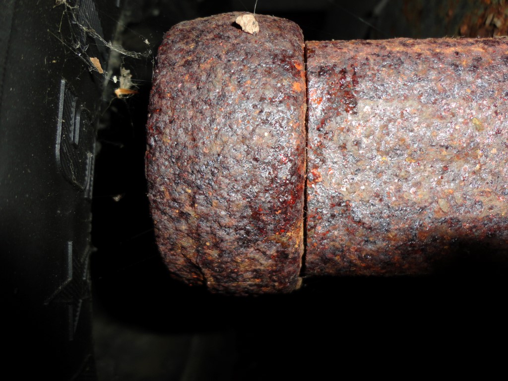

Looking at diagrams. Some axles have a bushing at end. Some dont. The stub on mine is welded on so I would think no way to pull it apart.

Had the same thing on mine. I only had 50 psi in each tire. had a vibration to. The tire calls for 90 PSI which i filled to that level and vibration went away buy the tire wear was done already. What is max pressure on yours.
Trailer and tire says 50psi. Thats what I always put in.Had the same thing on mine. I only had 50 psi in each tire. had a vibration to. The tire calls for 90 PSI which i filled to that level and vibration went away buy the tire wear was done already. What is max pressure on yours.

what load range are they

its rusty as #*$&@, you ever wash it?
cwhat load range are they
Yes. Its just rusty axle.its rusty as #*$&@, you ever wash it?
Well at least its a good lesson. If storing sleds in trailer put axle on jackstands.
yup, from the pics the rubbers in it are toast. seen some way worse than that.
put the frame on the stands. you want the weight off of the suspension. if you are replacing the axle, see if you can get at 3500 lb one as that one might only be 2000 lb rating. it is a way that manufacturers cheap out on them.
how much did it weigh on a scale without anything in it?

it will scrub a bit but not that bad. usually it is an axle issue.
