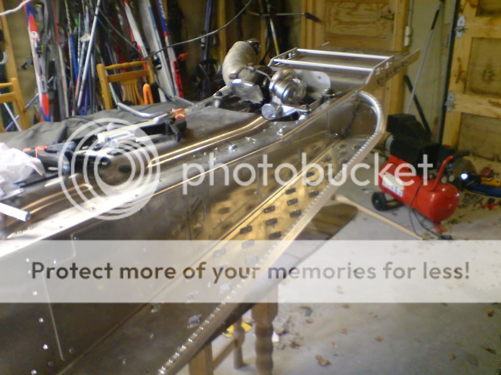

If felt the need to start a little work with the tunnel project yesterday. I have fabricated the kickup stand and cut the outer coolers/heat exchangers.
Here are some pics of the progress - so things are getting closer to welding and polishing
Brackets for the kickup stands
Outer heat exchanger cut and bent to fit the kickup:

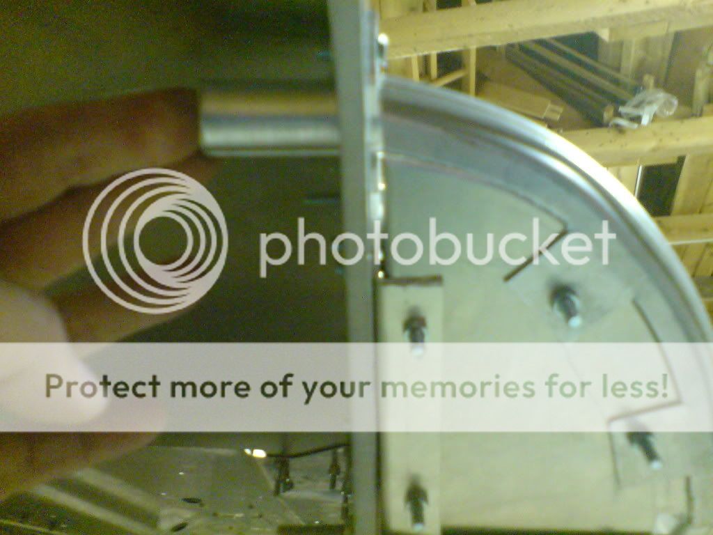

I made a small bracket that will be welded together with the outer heat exchanger. The bracket will be bolted or pop rivted to the tunnel sides when finnished.:
A pic inside the tunnel showing how the out heat exchangers end before being attached to the rear heat exchanger
Just a pic of the tuning forks/yamaha logo on the tunnel extension
TT
After a lot of cutting and grinding
the exhaust crate/basket is installed
TT
I just couldn't resist trying the "blower", exhaust palstic and seat on after the exhaust crate/basket was installed
When everything is pop riveted, welded it will be
I have to start work on the rear bumper and snowflap support
