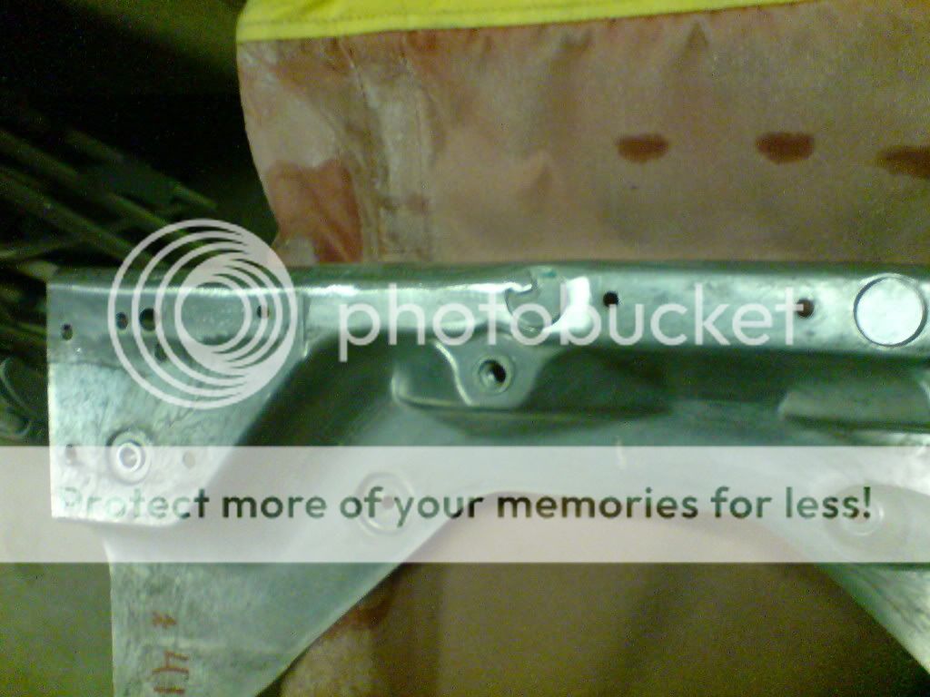

I finally got around to do some moore work on the tunnel.
The drop brackets/tunnel sides are 6mm/0.236inches. This tunnel is made to withstand some abuse under BOOST!!!!!!!!
This means that the OEM exhaust crate/basket doesn't fit. I have cut it up front and in the back - removed some material and had it rewelded for a perfect fit.
A big thank you to the welder for helping me out. He said it wasn't easy to weld due the the quality of the aluminium. But it turned out PERFECT
Re-installed in the tunnel
