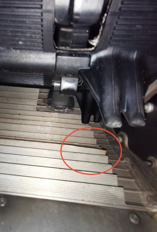

Hello. The radiator plate is slightly bent due to ice. I want to fix it. Does it need to be heated or can it be gently straightened without heating?

Be carful as you may end up with nothing instead of a bent fin. I would leave well enough alone on that.. Its not going to effect your sled that much with it being bent.I want to try to fix it. Do I need to heat the metal? Is it aluminum or alloy?

I wouldn't that isn't enough damage to worry about and it certainly won't compromise performance.

Like they say - “there is quitting” and then is “quitting while you are ahead”.
I would really want to get a good look At it before i did anything, which means remove the drive cogs and the cross shaft. If it is weakened enough, you will just break that fin off or worse.
And yes, if you gotta do it - use a heat gun and warm it up. I would use vise grips with the wide mouth - ones welders use to hold steel together.
