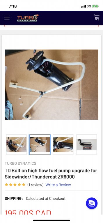

I have installed the TD pump, but for the bigger tunes. I have run the sled with less than 3 gallons with this pump with no ill effects. What about trying to re-arrange/re-route the pick-ups first, like putting one in the back? Cheaper than buying a pump. The TD pump is pretty reasonable $$$ wiseView attachment 153146 Anyone install one of these? And does anyone feel this helps with fuel starvation/sloshing? Or this just increasing your pump capacity for bigger tunes. I’m only running powertrail and have no desire to bump up hp. But I have a fuel starvation issue for sure. Thanks.

A cheaper route if you dont mind a little wrenching , I bought a Walbro 190lph pump off Amazon and put it in for my max spool17 tune . Working flawlessly so far. Tomcat sells a kit using the same pump

The pickup is in the bottom of the can, simply reroute the return line the way mike said and starvation is a thing of the past. Your tune isn’t that big to require a larger pump. If you want to upgrade a walley 255 is probably the best option, $100 done.

Those two tubes extended forward are not the pickup, they are siphon tubes that use a small amount of fuel through an orifice to siphon fuel and keep the surge full.
I’m pretty positive Mike’s fix will work, but for peace of mind a bigger pump is a good idea. There are several pumps you could use let me try and get the part numbers for the walbro 255.
