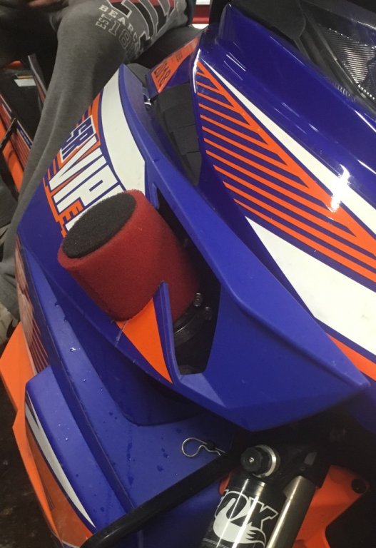

Run something like this if you want real CAI. The under-hood ones are all WAI (warm-air intake).Should i drill hole in hood and run external cai?
There is a pre-filter over this to keep snow dust out.
