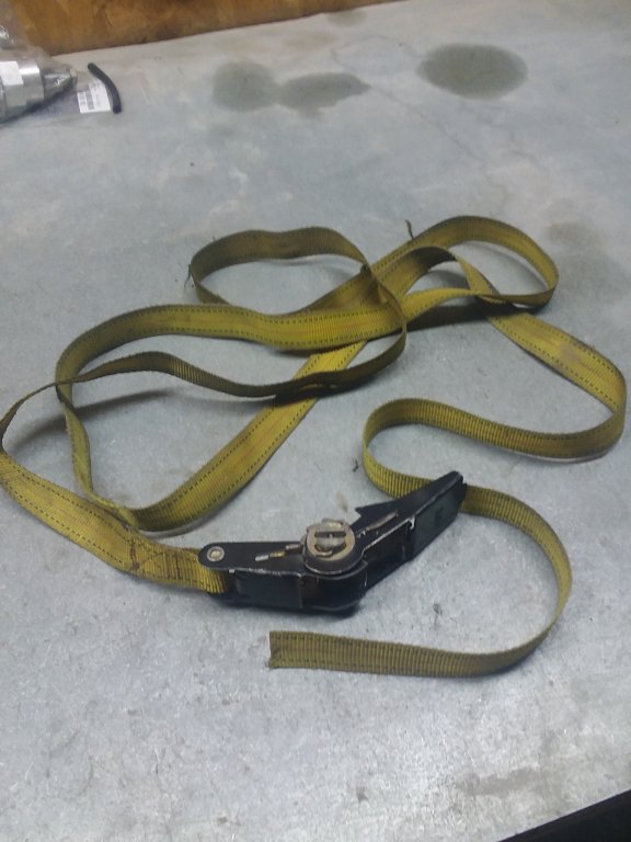

I put the stock shields on my SQ without insulation.  I put the motor side shield first, then the outside shield over it.  I used 2 ratchet straps to tighten the shields tight to the muffler and riveted them together with factory big/chrome rivets.  I used ratchet straps with no hooks, and put a peice of cardboard under ratchet to prevent denting/marring, making sure ratchet/cardboard on motor side in case it did.
I also riveted the shield to the upper bracket so shields wont ever move up/down or rattle. Been using it like this for 5 seasons, no issues. .

Ratchet straps work on quite a few tricks. I use them for, hole line up on rear suspension bolts, compressing the tunnel for ease of snap ring placement, etc..
You are not alone my friend. The best ratchet straps for winder repairs imo, are the ones fron Harbor Freight without hooks. T
 he hooks just get in the way, or make strap too long!!
 he hooks just get in the way, or make strap too long!!Motorhead

You are not alone my friend. The best ratchet straps for winder repairs imo, are the ones fron Harbor Freight without hooks. TView attachment 161161 he hooks just get in the way, or make strap too long!!
They do have a pretty good selection of tools and other. That’s my main tool spot since our Sears and other tool shops closed years ago. I do have some of those but mine are much shorter and heavy duty for tying my bikes down in trailer when traveling with them. So prior to putting my shield on I shall pay another visit to Harbor Freight, whereas I do want it nice and tight so it stays quiet.
