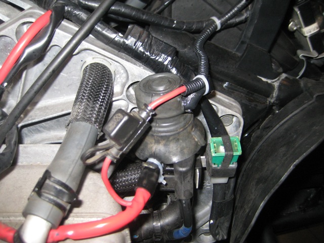

I put a little Truck-Lite anti-corrosion compound on the starter relay plug and added a boot over the top of the relay to help shed water. The boot came off a Yamaha Grizzly 660 head light housing.
