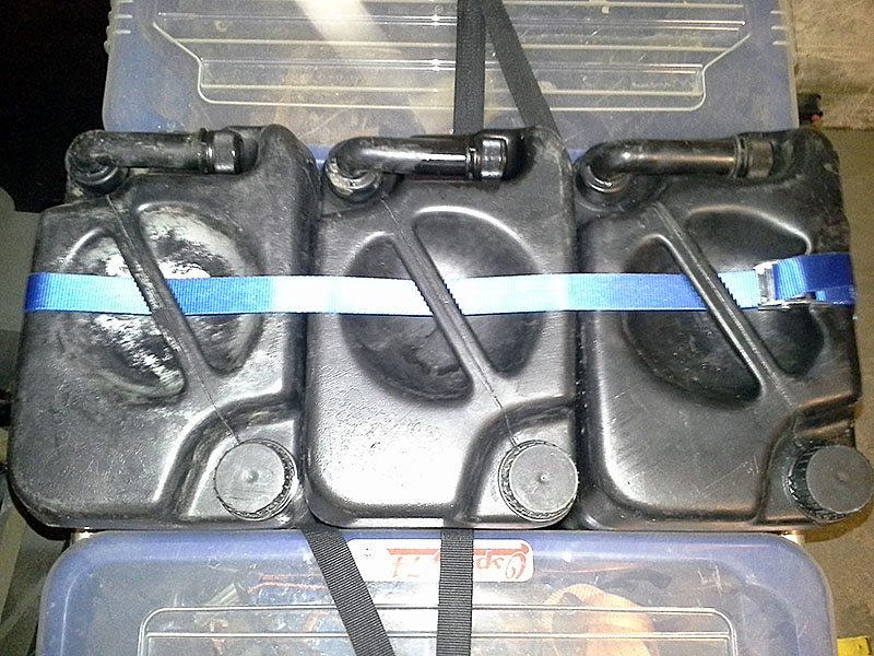

Added three 20 liter fuel containers to my cargo sled. Did not design the sled for these containers, but the fitted with in the millimeter =)
