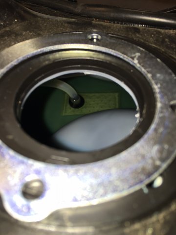

Finishing up a few details before letting this one loose. The viper fuel sending unit was still reading 1/2 tank on the Nytro gauge when it was actually empty so the resistance of the sensor was to low compared to the Nytro sensor. Luckily, no significant modification of the sending unit was necessary to correct it. Adding about 50 ohms in series was enough resistance to give a good indication of the actual fuel level and with a slight tweak of the float arm I was able to set the low fuel light.
A picture of one of two fuel pick up lines in the Viper tank.
Under the hood
