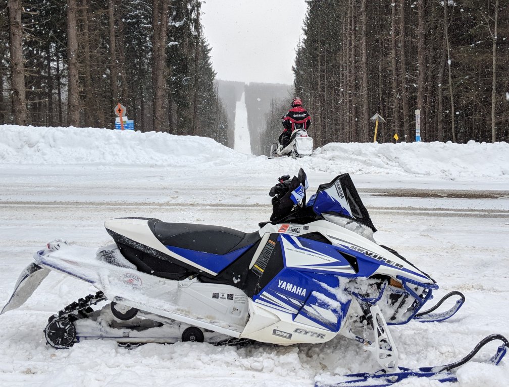

So, on a somewhat packed, less than a half mile stretch we lined them up on a rolling start. The Viper/Nytro hybrid, we'll call Vypro, launched to a few sled lead. At about halfway the stock Viper caught and overtook the Vypro about 4 lengths then they both were the same speed to the end of our test track. In the end stock wins but top speed was the same. We did this 3 times with similar results.
Is the Vypro starving for air on top end without the airbox mod or is it clutching? I'm sure Grizz has been racking his brain all night and will have plenty of ideas.
View attachment 139361 Grizz and finally got the 2 Vipers together for a comparison. Sleds were not equal but but close. Grizz's "stock" Viper has some clutch work, as does mine, but he's gone a couple steps farther and the hybrid Viper still needs some minor tweaks to hit the sweat spot. He also has modified the airbox.

He took me out of the hole every time and would continue to out pull me for almost 100 yards. Then it was almost as if he hit the brakes because I would rapidly make up 4 or 5 sled lengths and pass him by several sled lengths but then at top speed we'd be running about even. His clutches came off the Nyto but we are both running Schmidt bros stage II although I'm running Supertip weights. My secondary was also wrapped at 60° and I believe his was wrapped at 70° which would give mine a faster shift out making it a little sluggish on low end. His was also slightly tapping the rev limit at takeoff so he might even have a little more there with that corrected. The only way to fairly compare these two would be to put them on an engine dyno.
I really don't think the airbox mod makes that big of a difference. If there is any gain by doing that mod it's minimal and I hate the increased intake noise coming through. I believe it's the wrong approach and the proven cold air intake is the way to go. To often with these air and exhaust mods we hear about the Hp gains but for me I'm more interested in the torque numbers. I don't like giving up torque for minimal Hp gains especially for a trail sled...... Good thing the Mr Bill show isn't on this channel anymore!

To much clutter in Dan's picture...........That's better

Schmidt bro kits all have 14.7 mm rollers.... No hiccups at all with the Yamaha electronics in the Cat chassis. Makes me wish I went the same route as Dan did. He went from a 09 Nytro to a new 2015 Viper chassis at almost no cost after he parted out what was left of his Nytro.
While doing the comparison we also checked his speedometer for accuracy since I fabricated a new pickup gear with a couple more teeth. The new gear put him within a few mph of my stock Viper and after the ride he had 138 miles on his odometer compared to my 136 miles.
I kept my Nytro for a backup sled when I purchased the Viper because for the most part it has been very reliable. The Viper left me stranded once so far with a bad jackshaft bearing. I probably could have prevented that but I didn't think with only 1,500 miles it needed serviced yet. This starter stuff worries me ever time I hit the key. In fact every time I take the Viper out I always wonder what's next. On the last ride my engine got loud and I thought maybe I blew the muffler or header out but didn't find anything wrong and when I rode it a few days later it seemed normal again. I'm not sure what that's all about but maybe I should stop reading about all the problems people have had with their Vipers.
