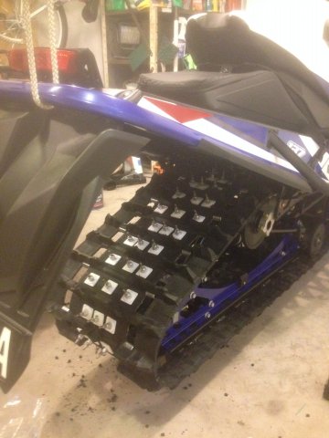

Here is my track all studded. 156 studboys 1.5". Just started testing on the clutching will hopefully have some good results by the end of the day. The clutching on the stock sled is almost spot on anyways so stock they run good. Raced the xf7000 again after they changed a spring and helix and viper in stock form is still faster. 7000 was over revving a bit yet on top end but the viper was running about 200 rpm to high on top end as well. Will post more results later today.

I have three per as you can see in the pic. Hopefully my trail turbo won't pull any out.i studded 2 per lug in the original track put 1800 miles on it pre-turbo, none pulled out. turboed and pulled out 8 in 900 miles, this summer i put on the 1.6 ice cobra. pre studded for the icy corners and not worry about throwing a stud through the heat exchanger. and the extra .3 of lug will help in the deep snow. my old track is for sale to if anyone interested. not studded in the outside and every stud that pulled out, pulled out a square no rips. cheap. any way the recommendation is if studding a turboed sled better load it up or none at all.
