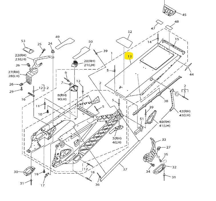

Can someone confirm that a 137 LTX can be stretched to 146 with just rail extensions without tunnel extension. Planing on running a 1 1/4” lug with studs in the center no more than 1/8” penetration above the lugs. If it’s a go, is any suspension changes needed.

I cant verify a 100% but I am pretty sure its a non issue.

Nice work!! I didnt have the time to look that up. ThanksWell, when you compare the micofiche for this tunnel extension between the LTX and XTX Viper models, they both use the same part so I would concur with @MrSled
