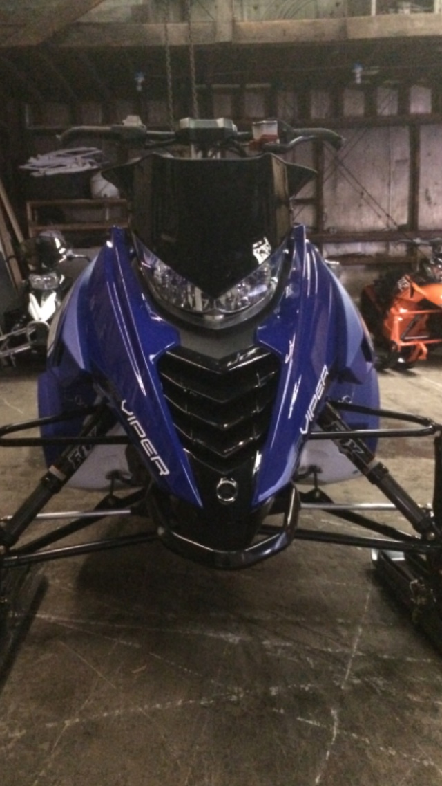

I've compared both sleds side by side and by looks it seems like they will fit. Haven't had a chance yet to try one but took measurements from screw to screw and they all measure the same. The 7000 uses a different windshield than any of the other cat sleds and it appears that it may work. Will try later tonight as I have a buddies xf7000 sittin in my garage right next to my viper

The xf 7000 windshield does fit the viper. No hole drilling or any modifying required they bolt right on. Only the 7000 windshield will fit. No other cat shields will without drilling. Hope this helps answer a lot of questions. Can't upload the pics for some reason it says they are too large. Check it out on my Facebook. Barry Roes
Be nice to get that windshield in clear than paint it to colour match our sleds.
Here it is

thats what i was looking for. looks better too.

I think in time I may invest in a white 7000 windshield and white skis. I think it would look sharp on a blue se. Would like to see pics of it first tho before I spend a bunch on skis
