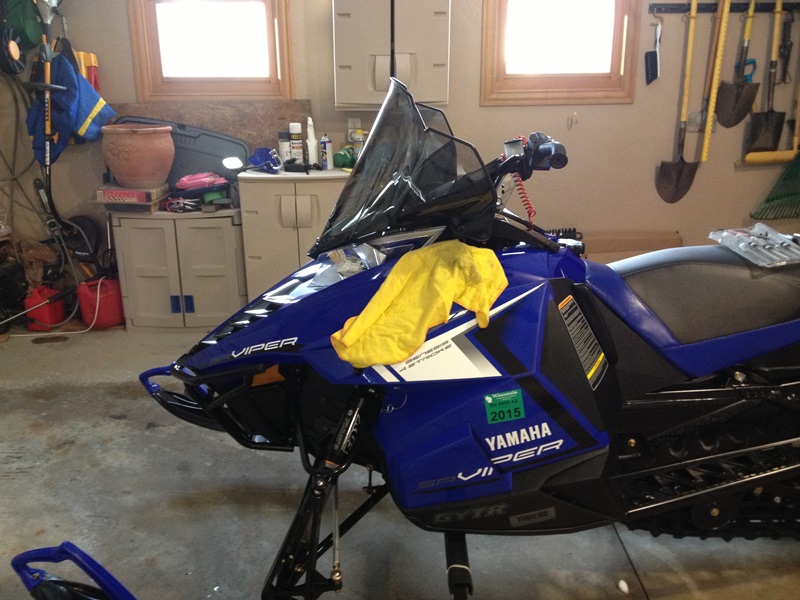

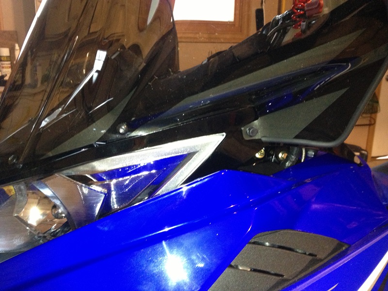

Put the AC mid height ws on today. Really wasn't that bad after the wings were removed. I only had to drill 2 holes in the black plastic near the headlight assy. The photos show the details. Note I did have to cover the AC decal that was built into the ws...
