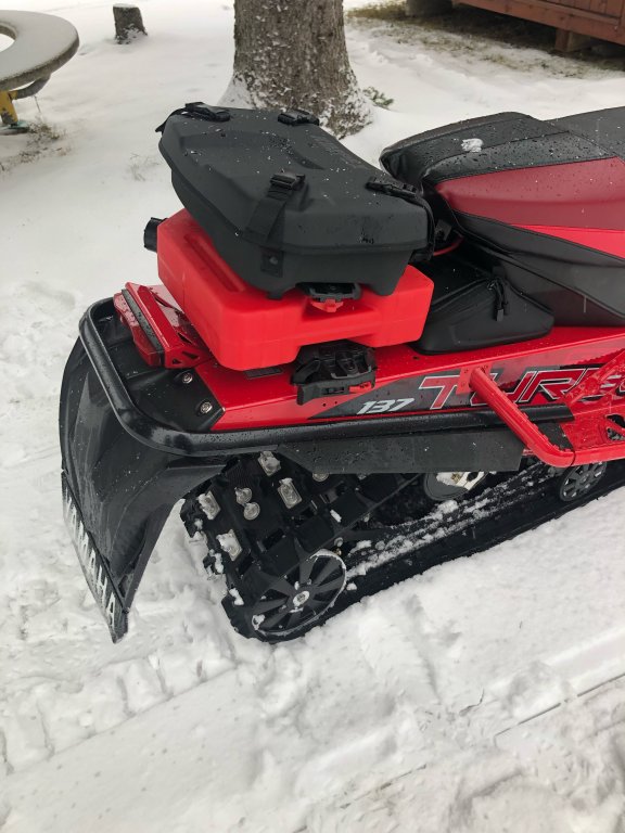

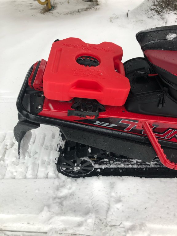

I added the
Kimpex Connect system
Stackable Roto Pax or Fuel Pax
Kimpex Adventure tunnel bag....
Or two stacked cans...
And
They are lockable
2022 LTX GT
And
They are lockable
2022 LTX GT

Any chance you could post up some pics of your set up on your sled? I've been interested in the Kimpex setup.I added the

Couldn’t get it done but lots on YouTubeAny chance you could post up some pics of your set up on your sled? I've been interested in the Kimpex setup.
SnowTrax Luke Lester did a good one.
I didn’t get my sled in time to use it so no long term review.
Seems good and comes with a template for drilling holes.
Works along with factory 20” tunnel bag.
I did a test to find out about how many days clothes it holds, 3 days worth depending of course on the individual

I’m about 100 miles north of ya if you get up north sometime you can check it out personallyAny chance you could post up some pics of your set up on your sled? I've been interested in the Kimpex setup.

Just a tip, when I in stalled mine I first tried the kimpex template on a piece of plywood and sure enough the spacing of the wholes was off, the fuel can or bag mounts will be a tad loose/wiggle around when locked down. I can’t remember off hand what I drilled mine at but can post the measurements once I measure mine.Any chance you could post up some pics of your set up on your sled? I've been interested in the Kimpex setup.
Yamascotty
- Sep 28, 2021
- 159
- 93
- 93
- Duquette mn
- 2022 ltx GT eps
Nice picturesJust a tip, when I in stalled mine I first tried the kimpex template on a piece of plywood and sure enough the spacing of the wholes was off, the fuel can or bag mounts will be a tad loose/wiggle around when locked down. I can’t remember off hand what I drilled mine at but can post the measurements once I measure mine.View attachment 168511View attachment 168512View attachment 168513View attachment 168510
I thought similar
Just cut to fit the paper template and secure to tunnel
Center punch marked locations for drilling
Attach mounting base
The reason I almost drilled my own holes was because the gas can holder has bolt holes for Polaris Ski Doo and Yamacat
Fool around till ya figure out which holes are right
It’ll fit great
