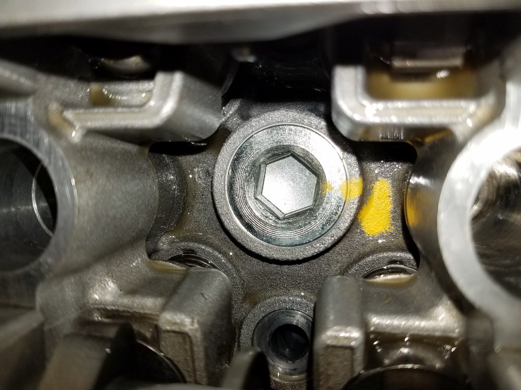

The heads tend to crack around the casting plugs visible under the valve cover. The plugs look like big pipe plugs and the cracks are hard to detect but around these. I think it was Turboflash that posted a picture of the cracks a few years ago?

HABS - PM me. My '17 had a cracked head from factory. I can show all kinds of pictures and what to look for. It's a factory assy problem.thanks fellas il have to pull the cover n see whats going on... i shoukd note this sled has never did this befor, everytime i ride it it gets put back in a heated shop and panels pulled, i check coolent,oil and for oil tank leaks every time! this just happened yesterday,running it pretty hard for an hr, just swapped my clutching over to tp,sled is bang on now , i thoght finally im done dialing and messin with this unit after 5 yrs lol.... now this...... any tips tricks speacal tools, timing, advice would be appreciated,if it turns out to be a head get used complete? or bare yamaha n seap valves? wich brand of head gasket everyone using and im assuming arp stud kit

I’ve had a few cracked heads around the casting plug . Worst one was we ordered a new one to replace the bad one and it was cracked too.

thats not good! my first step is finding the correct adapter to verify the leak, once verified, a new possibility cracked casting from ysmaha? or just get a used complete head? are their torque specs on thise plugs? mesning remove em ,reseal em and properly torque em in used or new?I’ve had a few cracked heads around the casting plug . Worst one was we ordered a new one to replace the bad one and it was cracked too.
