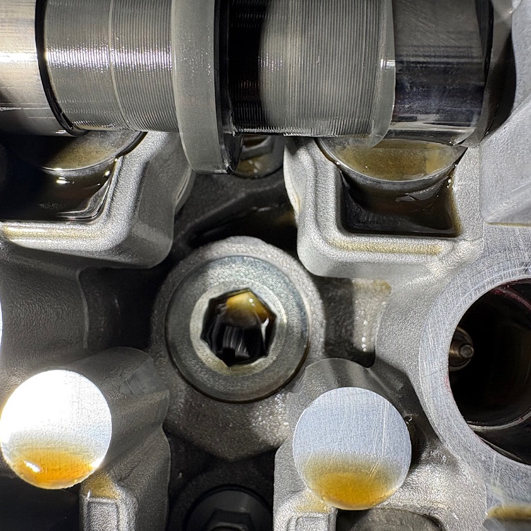

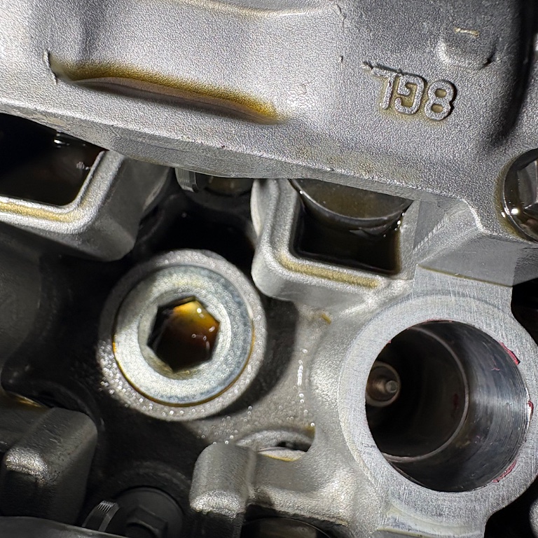

The plugs don't leak. The issue is whatever torque is used to install them must be too high. It cracks the boss around the plug.thats not good! my first step is finding the correct adapter to verify the leak, once verified, a new possibility cracked casting from ysmaha? or just get a used complete head? are their torque specs on thise plugs? mesning remove em ,reseal em and properly torque em in used or new?
If it was me, my design would use a plug with straight threads and a plug with a nice high-temp silicone oring. The outward force on the aluminum boss in the head as the pipe plug is screwed in is sometimes too much for strength of the boss, so it cracks. Nfg.

correct, the plugs being npt are tapered n crack the boss, wondering on a new casting.. remove the plugs, reseal woth pipe dope or whatever and torque the plugs in place with a possible lighter torque, so after some heat cycles it dont crak again? just a thoghtThe plugs don't leak. The issue is whatever torque is used to install them must be too high. It cracks the boss around the plug.

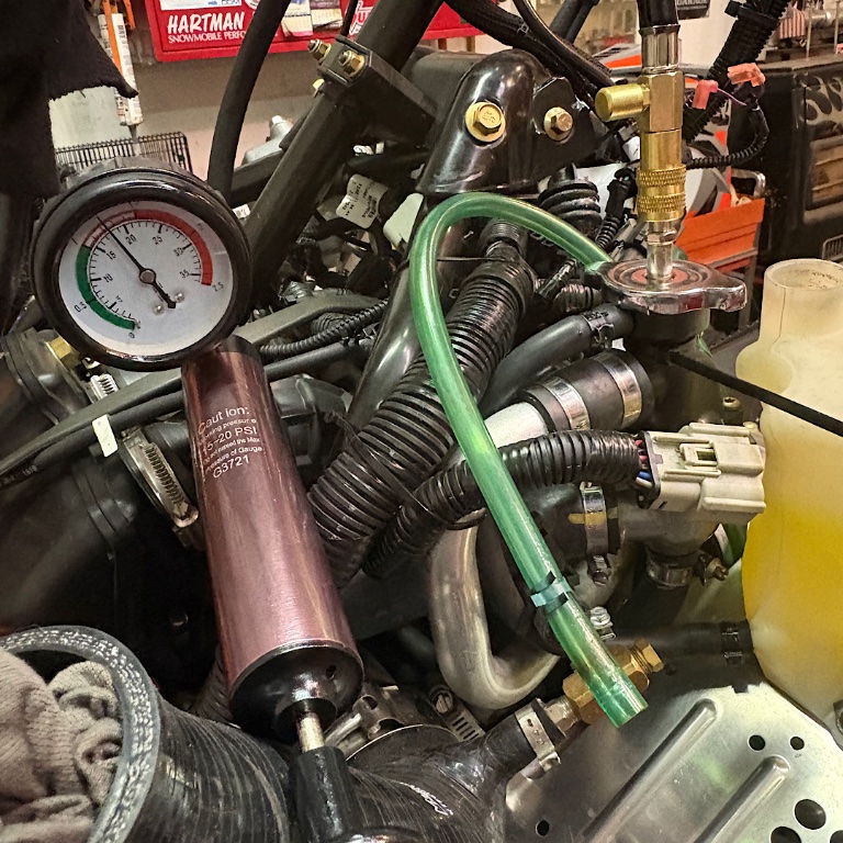

just a bit of an update..so i took a oil sample n sent if off.. results were high levels of coolant.. action required! the system is 16lb.. i have 18 lbs in it.. cant see any coolent or crack around those bungs... sprayed with soapy water , no bubbles... mabe its cracked sumplace else? either way im takin it off to inspect and stud it.. i just cant see it being a gasket bc it didnt pressurize system it lost coolent.. anyway i will update again but will be a while

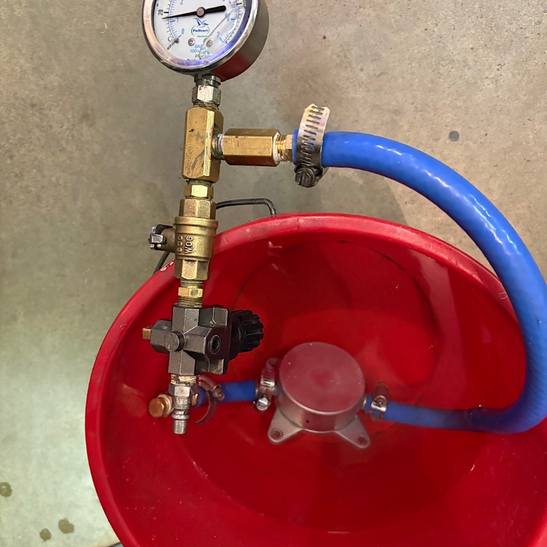

did you end up testing the oil cooler? probably worth doing that before yanking the head i would think. what adaptor did you end up getting for the pressure test?

Your pressure test may not show bad at room temp, engine temp of 165+ will cause aluminum to expand and could be opening up crack.

Pressurize it more, 24 psi.

i got a china kit off amizon, gives u a huge assortment of caps n stuff.. was like 80 bucks, its cheap but worked, i have a good stant one but nothing to adapt to the sleddid you end up testing the oil cooler? probably worth doing that before yanking the head i would think. what adaptor did you end up getting for the pressure test?

i will when i get back to it... and will post here to update.. im thinking now i have the coolent mostly drained from the sled , put 24 psi of air pressure in system... and spray those pipe plug bungs with soapPressurize it more, 24 psi.
