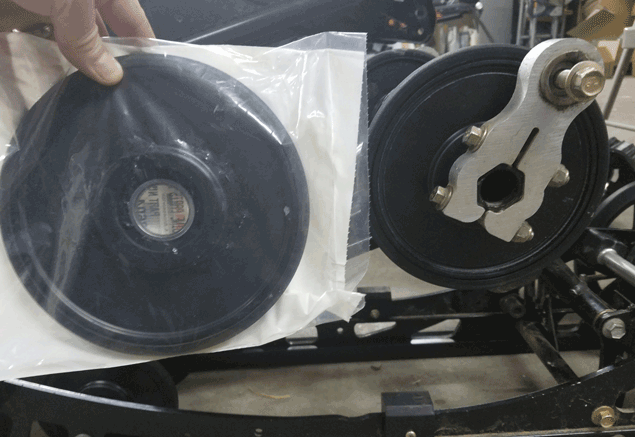

I noticed I had a dry bearing on one of my bogie wheels. Since it was 4 bucks more to just order the entire wheel with the bearing, I pulled the trigger on it:
However, when I went to install it I noticed it was much bigger than the other wheel:
Stock was like 6-6.25" This is 7.5"
What am I missing here?

8JP-G7312-00 on the bag vs 8JP-G7312-00-00 the # on the diagram. Is that the difference?

Called my dealer. They are going to look into it but they think the parts fiche has the wrong part number listed.
The arctic cat part # is 3604-901 and that's listed as a 6.38" wheel, which matches what I have on my machine. I can't believe that Im the first one to order this part from yamaha?
