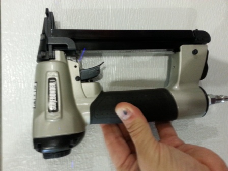

Cannondale - just want to interject that I installed aftermarket seat heaters on both of my Vectors and had I not had the correct staple gun, yes, it would have been a major pain. I first tried an electric staple gun but it didn't have enough "oomph" (real technical term I know!) and I went back and bought an air stapler and it worked great.
Bottom line - if I can do it....anybody can do it! LOL!
