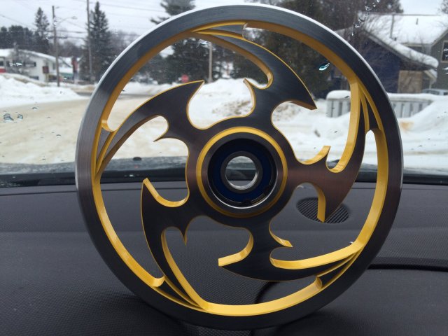

Just added two read 8.5 " tricked toys billet wheels with the inner spokes in yellow powder coat.
6004 bearings worked perfectly and looks killer... Used the skidoo wheels as the fittment.
The stock black discus wheels just don't do any justice.

The workmanship is outstanding....
