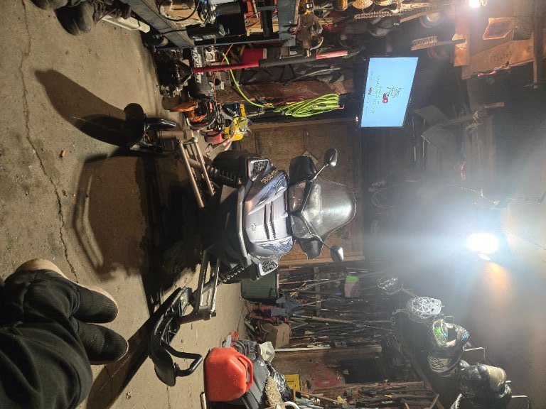

I have a issue with my 05 rs venture. The hand and thumb warmer are not displaying on screen. And fuel gauge flashing constantly. Not sure where to start to look. The hand warmer seem tk work wheb idling. Just not displaying on screen. Here as a photo of it. Bought it for 180p. Not running. Spark plugs were fouled. 8200 kms.

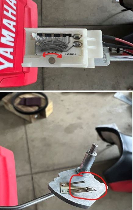

I was going to mention a faulty fuel sending unit as a reason for the fuel gauge flash. May want to check out my post where I cleaned the contacts on the sending unit. May just need a good cleaning.

Correct, when I had an issue with my sending unit, the tell tale sign was the flashing fuel gauge; even when fully filled.
I was able to clean up the contact surface so that as you moved the contact across it, it would read normally but ultimately, there was still a bad spot that once the contact came in contact with that section of the contact surface, the fuel gauge would begin to flash and had to be replaced:
