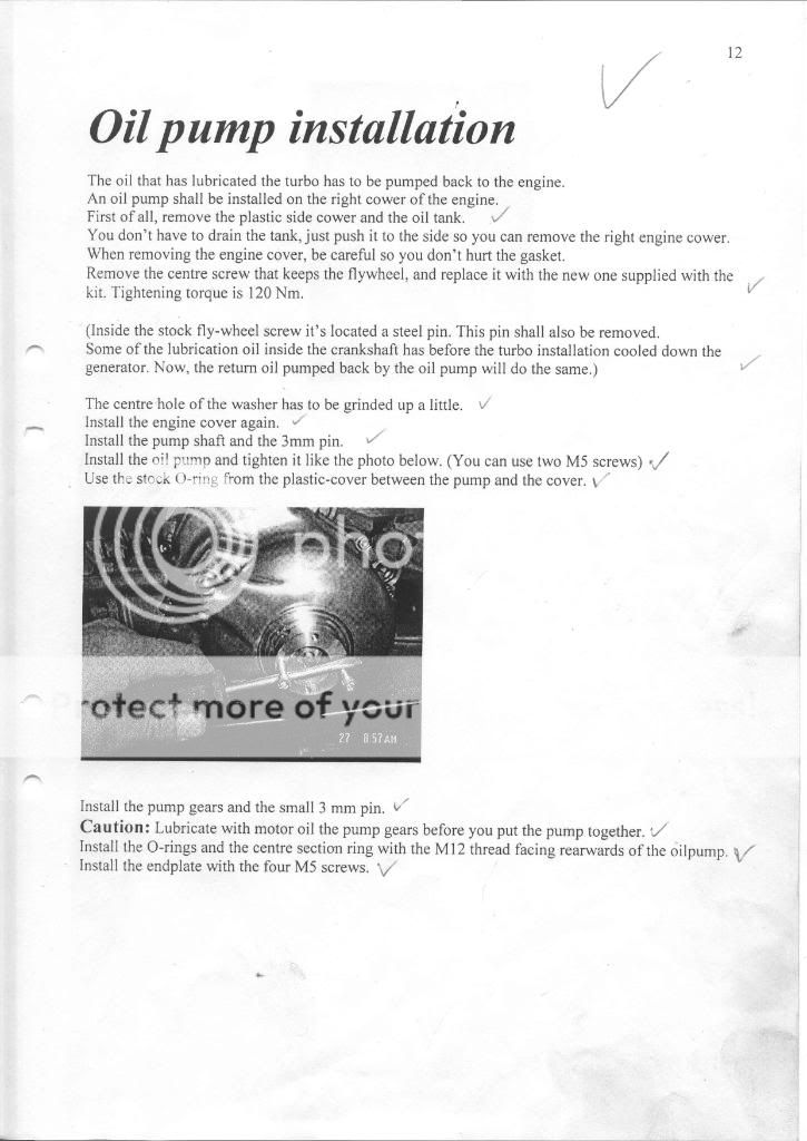

Started to mount the oil pump. In the manual it says to grind the centre hole of the washer. I'm guessing it must be the washer on the fly wheel bolt, which we change out. But why, what for? In my mind i can not see why to do it, as the new bolt fits the washer perfectly. Any other views on this matter?
Picture below shamelessly lended from rxriders excellent thread..
And on another note, do you guys use thread locker (like lock-tite) on the threads on the new oil filter housing bolt? I noticed some yellow stuff on the old oil filter bolt/pipe when it came out...
