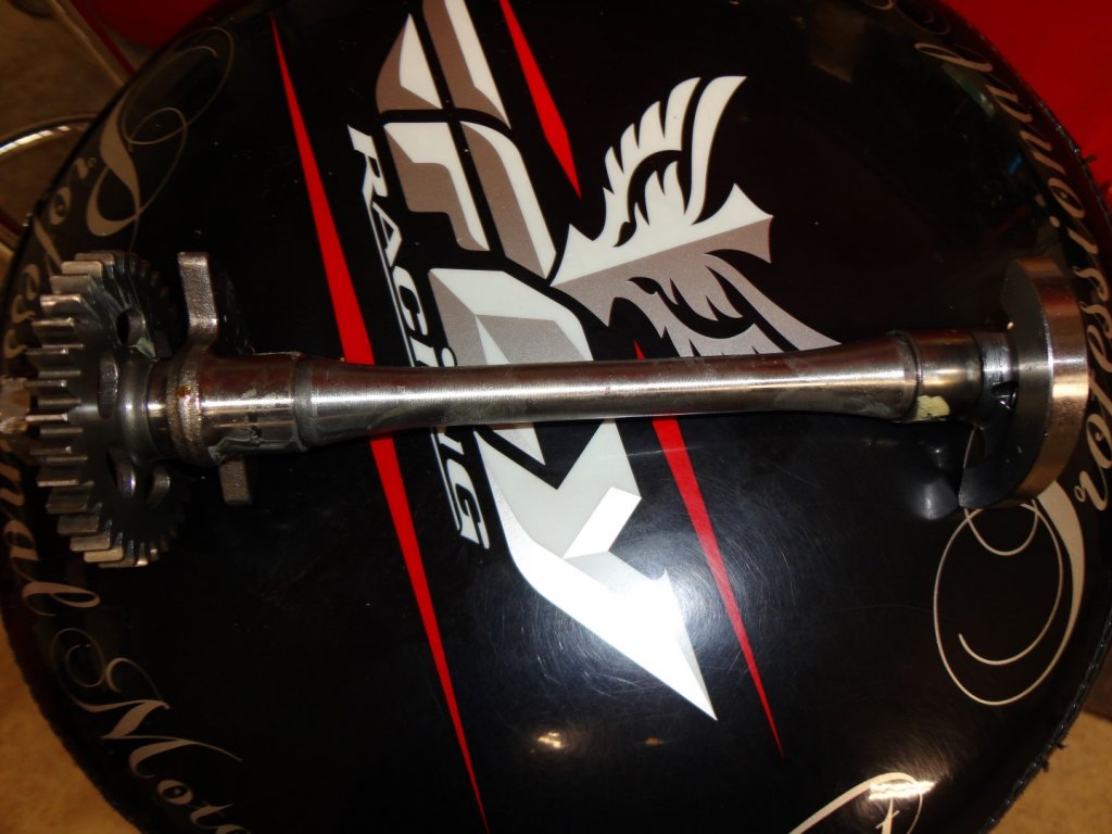

That deal did fall through but I just re-ordered yesterday from Yamaha. It has to be an 08 or newer. You can tell because the 07 has a nut on each end but the 08 and up has the counter weight a permanent fixture on the non-gear end. No nut.I have no idea but since its one that the reduction gear failed on I suspect 07.

Looks like 07
This one has nut each end. So definitely 07.That deal did fall through but I just re-ordered yesterday from Yamaha. It has to be an 08 or newer. You can tell because the 07 has a nut on each end but the 08 and up has the counter weight a permanent fixture on the non-gear end. No nut.

Darn, too bad. I would have cancelled my order and got it from you otherwise.This one has nut each end. So definitely 07.
I wonder why they changed that and why it matters? They sure made lots of changes on Phazer early years. This is new one I never heard. Thanks

The old one has a slight wobble. Notice how the gear in the original pictures is burnt on one side but not the other. You'd wonder how as there is also a bearing holding it in the right side cover...?I wonder why they changed that and why it matters? They sure made lots of changes on Phazer early years. This is new one I never heard. Thanks
