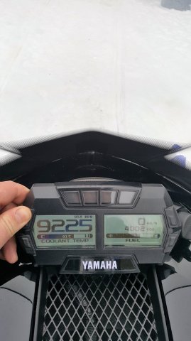

Hey just went out for a good run! I did a wide open run 5 time and got the exact same speed and rpm!
My top speed was 171 kilometers per hour(speedo) and rpm's were at 9225 each time.
Should I be adding weight to weights?
I didn't hear the rev limiter what so ever but not sure if it's a tad high!
Btw this thing pulls hard more then I expected!!
I have the cotc with 4.5g in tips already and I think 2g in center!
sleds mod are cotc, airbox, sandales pipe and pc5 with hurricane map

this was the fastest the sled has ever went so far!!!! pretty impressed

shadow44
171 km/h is 105 mph....that's pretty good. I personally feel this motor works best at 9000 rpm...but if you like it at that rpm leave it.

I am very happy with top end and don't expect anymore!
4.5 g in the tip is the max I can find with 8fp weights
If I did want to add weight it would have to be in center hole! Not sure how that would affect overall performance(I have 2g in center as is)
From what I noticed it hits 8700rpm then climbs from there
sxr70001
- Dec 4, 2010
- 1,168
- 774
- 1,438
- Michigan
- Sidewinder LTX SE
SR Viper RTX SE
Sounds about perfect to me.

ya I'm not going to f**** with it seem pretty spot onSounds about perfect to me.

Don't touch it !ya I'm not going to f**** with it seem pretty spot on

Leave it alone for god sakes. On the jack stand mine revs 9200 before hitting the limiter. On the snow the highest I've hit is 9100 and I've hit 161kph on a plowed road but only once. It consistently runs 150 but I'm 265 lbs.
