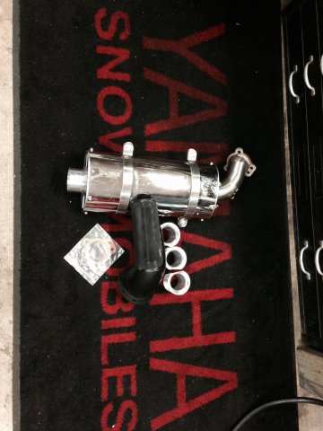

Following up off of this post. We did about 300 miles this weekend on the hill. Real cold, and a lot of flat trails early on. I was constantly seeing 96-98 MPH with this set up. It is a completely different sled in the Mid and top range and the sound is awesome. Fit and finish are exceptional. You cant go wrong. looking forward to my next trip.In quest for that goal of consistent 100mph runs I installed the Excell system. And a Ulmer Tuned PCV. I would rate install as a 5 on difficulty scale of 10. Read and reread the instructions especially airbox mod. They have very nice instructions included.
While the can mounting system looks kinda subpar it actually is very solid yet will allow flex of the sled. I have found straps around entire can to be way stronger than tabs welded on long term. Stainless and machined aluminum. Very nice welds except at pipe bend. Repackable. Perfect.
Airbox snorkel is no cheap plastic rigged piece. It is actually some type of rubber. It is molded to shape. I know what a mold for this costs to make and it is very impressive that excell would invest this kind of $ into making something for us. Impressive and comforting surprise.
Took it in ditch and it was noticeably louder than stock. I expected that. Banging rev limiter right away launch and not enough ditch to do top end run. I then added 3G to tips and had to go to work. Left for Norway,MI where there is snow at 1:30 sat same day so no more testing time. Unloaded and road in search of supper. Still hitting rev limiter slightly at launch and hard at about 88mph. Had a lot of fun and little ride for supper turned into almost 100mi! Making excuses but I slept like a baby. By time I got up all I had time for was adding 6grams to mid. Launch is almost perfect but still banging rev limiter but now at about 94mph. Sunday morning trails were still not groomed and it just wasn't safe to hold it tight for long. Did not find groomed trail till dark so stay tuned for final clutching and speed but it definitely has gained power since I had perfect clutching before. The exhaust seemed to get quieter as I rode. I payed attention and on groomed grade all I could hear was track howling by end of day. I never once heard the intake! This system may be ok even for me and I demand a exhaust that won't piss people off. We will see. Cold air intake plain and simple works. While riding about highest air temp I saw was 37deg f. Normally I am 70 or higher even at - 30 deg F.
Very happy and Excell did a great job. I can't wait to get the clutching right. I will post final clutching in clutch setup sticky.
