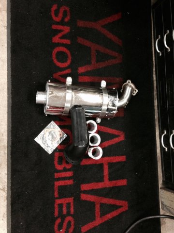

In quest for that goal of consistent 100mph runs I installed the Excell system. And a Ulmer Tuned PCV. I would rate install as a 5 on difficulty scale of 10. Read and reread the instructions especially airbox mod. They have very nice instructions included.

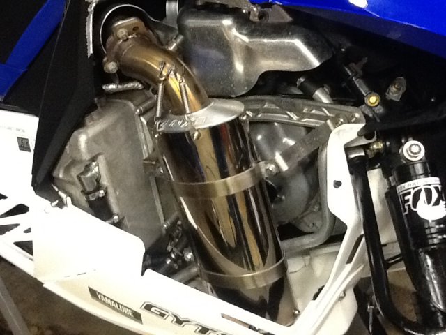

While the can mounting system looks kinda subpar it actually is very solid yet will allow flex of the sled. I have found straps around entire can to be way stronger than tabs welded on long term. Stainless and machined aluminum. Very nice welds except at pipe bend. Repackable. Perfect.
Airbox snorkel is no cheap plastic rigged piece. It is actually some type of rubber. It is molded to shape. I know what a mold for this costs to make and it is very impressive that excell would invest this kind of $ into making something for us. Impressive and comforting surprise.
