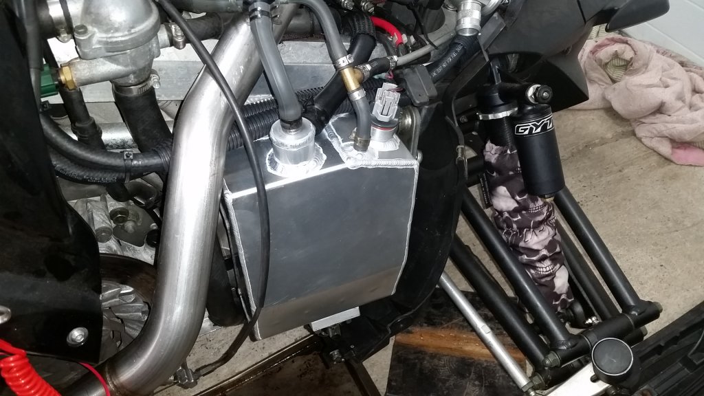

Here is my 07 Venture sled picture.. Its still on Ebay I sent him the picture for making the first one... mine was the prototype so i hope they are larger now ?? Its the last picture on the ebay post.
Has anyone else had any issues with extra oil in the air box on a CFM oil tank ?? It wont happen on short runs.. I'm taking about a 250-300 mile weekend.. Then I have to add oil.. With the OEM I just did a 300 mile weekend and did not have to add oil... But it did drip some on the ground..

You can see that the tank is larger toward the coolant hose.
