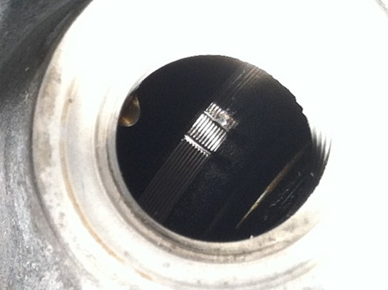

Yea mine is in between the 2 lines.This is the normal position to align the flywheel marks in the stator cover window.

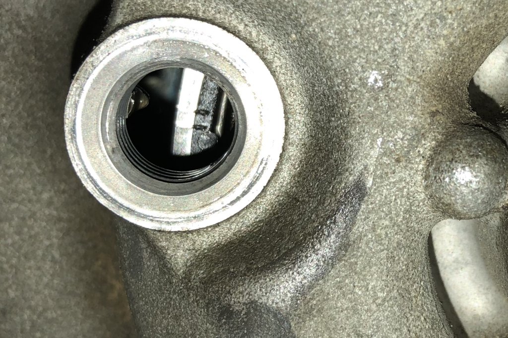

This is where I’m at
grizztracks
TY Advertiser
- Feb 24, 2005
- 3,120
- 980
- Scio, NY
Then you are good. If it's off buy even one tooth when the cams are aligned those marks won't be anywhere close. Did it really jump time or did you think it did because it wasn't on the single mark?
