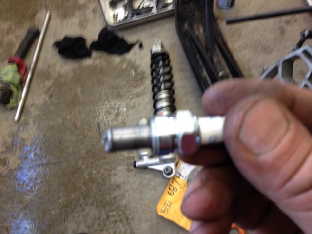

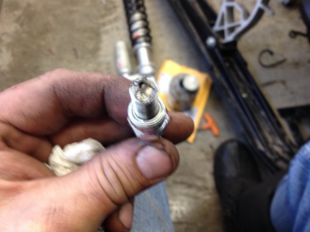

Yup...
Centre plug...

Was it a lean burn down or a crank bearing failure? What was left of the piston?
Pete

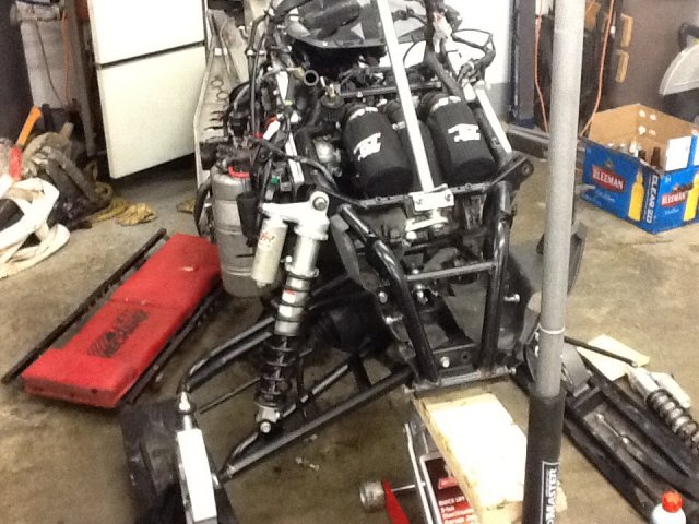

Haven't opened it up...the guy I bought my engine from wants to buy it...he is a yamaha mechanic so I'll probably sell it and find out from him...anybody have an ideas what a engine is worth that has a hole in it? Rod took out the starter...stator is good not sure what else? BTW if anybody is thinking of changing an engine it's not that difficult...just takes a long time!
After a motor goes like that normally not much is salvageable. The head might be okay as long as the piston didn't make contact when the rod went. I had one do the same and all that was good was the head (after replacing a couple bent valves), stator and a couple pistons and rods. A few other odds and ends. Not sure what a damaged one would be worth but I'm thinking a couple hundred dollars??
I see your plug was damaged so the piston likely hit the plug.
