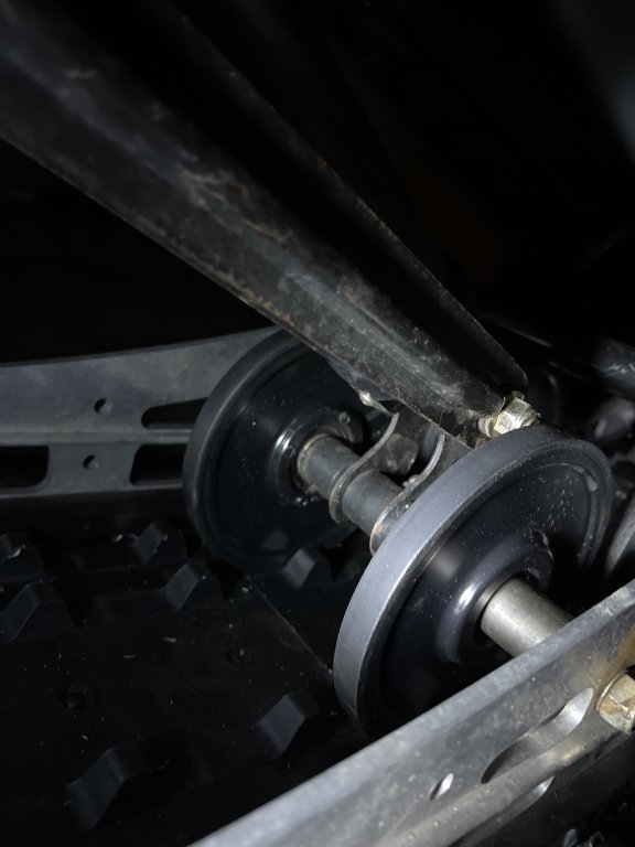

Can anyone post a picture of how the rear arm shock is attached to the skid of a 2015 L-TX? We just went through the service manual and saw at least 3 different placements in diagrams. Mine is setup with the "C" bracket above the idler wheels and the open part pointed towards the rear. At least one diagram in the manual shows that being completely backwards with the open part of the C pointing forward and the shock sitting behind the idler wheel almost touching the track.
Hopefully this helps
