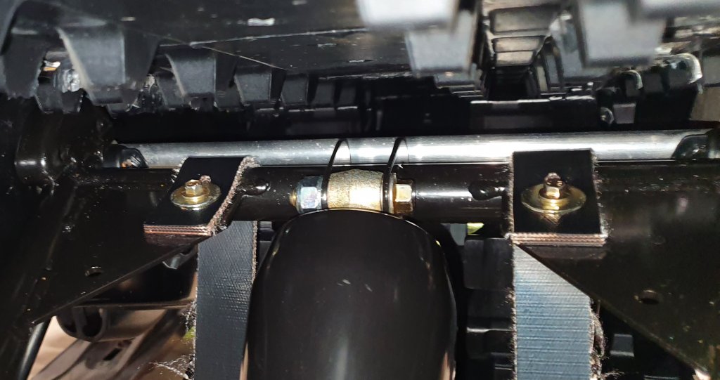

What hole are you running your limiter straps in?
Not sure if you're asking me, but mine is in the stock location, which I believe is the longest hole.

My 2020 had one hole to go from factory but is almost covered by the washer so hard to see.

- 2021 Sidewinder LTX GT
This is my limiter straps. Stock location. 2021 LTX GT.

Now the Bolt is in the UPPER HOLE. No more Lower hole. Hmmmm

Under that big washer you will find more holes in the strap.
They move on the LTX too?

This picture shows it in the lower hole

Must be for the Canadian destined sleds! Ha!This picture shows it in the lower hole View attachment 160430
