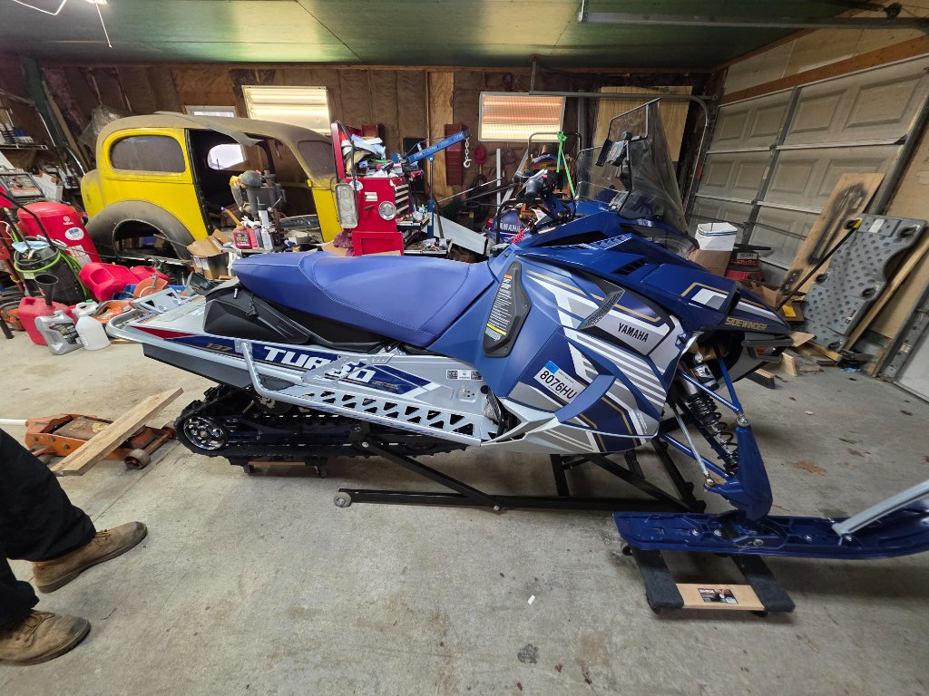

i have the same sled and was wondering what length studs you put in yours? i keep hearing so many different things about lengths anything from 1.320 up to 1.875Update so far. Studded center of track. 192 mega bite. All doubles. STM tunnel protectors. Added BRP rear scratchers. Fit nicely under the tunnel flares when not in use. Hurricane gold charge tubes. 4th wheel kit installed with Barn of Parts plastic deletes kit. LJE trail courtesy light. View attachment 179300View attachment 179301Next up will be scaggs. Big thanks to my Brother in law and Father in law for the help.

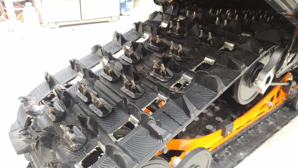

I used the woody's pattern and added a second double where the single was. Will see how it works soon I hope.

I hate how the Woody's patterns are always so far from the windows. When I use their patterns, I spread the pattern to have the edges of the backers on the widest rows to be within about 1/4" of the windows.I used the woody's pattern and added a second double where the single was. Will see how it works soon I hope.View attachment 179460
With the plastic Stud Boy Super Lites never had a problem going Even with the window on the edge of the Big Double backers. Gives you some more scratch linesI hate how the Woody's patterns are always so far from the windows. When I use their patterns, I spread the pattern to have the edges of the backers on the widest rows to be within about 1/4" of the windows.

I'm not racing so it doesn't bother me too much about the extra scratch lines. I was looking for safe, trail riding mainly. But I do agree with the studs being able to go wider then they are.
